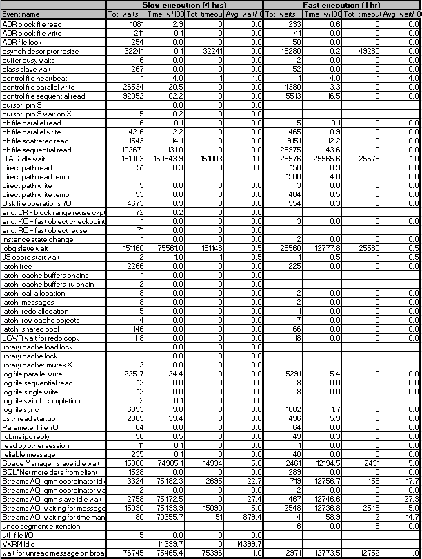

    I figured out how to get some wait statistics. Here is a table comparing a slow execution (3 hrs) vs a fast execution (1 hr). Keep in mind that all tests were done on the same server, alone, database was restored from a backup every time, and Oracle was shutdown and restarted between each tests. Usually the slow tests happens when the Oracle server was sitting idle for a few days (like a weekend):

    Look at this particular wait events and research what they mean...
    jobq_slave_wait,
    *parallel*,
    db_file_sequential_read
    My take is that "slow" process is doing parallelism while "fast" one isn't.
    "slow" process is also doing a lot more of reads by index (db_file_sequential_read) than "fast" process does - Something is different, Oracle would not choose different execution plans just for the fun of it.
    When you say... "database was restored from backup", is that a real datafile level backup or are you just imp or impdb the data?
