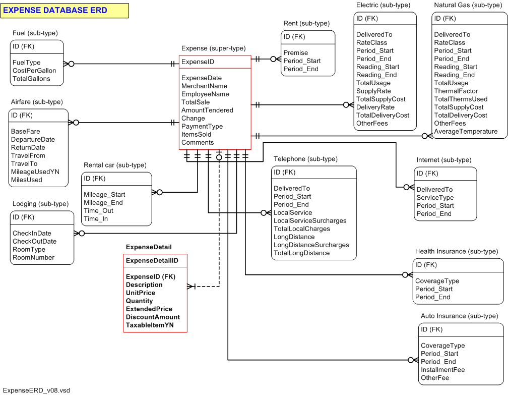

    Anyone that has anything constructive to add is welcome to join in!
    citldba, I have had a few other people say that using a Super-Type/Sub-Type approach would be reasonable and is a good way to avoid having a "wide" table with lots of Nulls.
    I also think it encourages keeping "Apples with Apples" and "Unleaded with Unleaded"!!
    Attached is an ERD I created yesterday. It is far from complete, and does not show everything, but is a good sample of what - I believe - we were discussing...
    Just Bob

    Yes, that looks like the sort of thing we have been talking about

    Quote Originally Posted by citldba
    Okay, good!
    Is there a need for each Sub-Type Table (e.g. Telephone) to have its own PK (e.g. "TelephoneID") plus a FK (e.g. "ExpenseID") to link back to the Super-Type Table (i.e. Expense), or is it okay to just have one ID field that is both a PK and FK?
    Just Bob
  4. #14
    Feb 2004
    UK
    56
    I'm not quite sure what you mean. If you don't have a sub-type id (e.g TelephoneID) then you are restricted to 1 record in each sub table per super type record (so only 1 Telephone record per expense).
    If that is what you want then you don't need to sub-type keys

    No, you didn't understand me.
    This is what I meant...
    Fuel (sub-type)
    ID (FK)
    FuelType
    CostPerGallon
    TotalGallons
    or...
    Fuel (sub-type)
    FuelID (PK)
    ID (FK)
    FuelType
    CostPerGallon
    TotalGallons
    In the 2nd example, does having a "FuelID" (PK) add any additional value for a Sub-Type table? (Obviously you want a true PK for a "regular" table.
    Oh, and I think I have actually seen a third way...
    Fuel (sub-type)
    FuelID (PK)
    ID (PK)(FK)
    FuelType
    CostPerGallon
    TotalGallons
    where you create a composite PK. Again, does this provide value?
    Just Bob
  6. #16
    Feb 2004
    UK
    56
    I think as long as you only need one sub-type for each expense then option 1 is probably simpler.

    So Bob, what happened with all your sabre-rattling arguments about...
    Quote Originally Posted by Bob Just
    ... I know lots of people - Oracle included - who would disagree.
    From a datatype standpoint alone, I disagree.
    You don't buy 10.57 bananas!
    "ItemQuantity" is an Integer. "TotalGallons" is a Real number. As such, they aren't logically the same thing.
    I can see a single "Quantity" field in the last version of your documentation. Are you going against your own convictions and the opinion of "lots of people -Oracle included" just to make me happy? that's very brave indeed.
    You know what... you are welcome! Oops... you forgot to say "thank you"
    Today is your lucky day Bob, here is a hint. In your current design -which in any way means I'm endorsing it - your sub-type tables should have a one-to-one relationship with your ExpenseDetail table, not a one-to-many with Expense table; it just doesn't work. I'm telling you this just because it hurt my eyes.
    Now you are free to say whatever you want -that's immaterial - you already know sooner or later you will have to revise it and do what I'm suggesting.

    Quote Originally Posted by PAVB
    Hi
    I second that most of the Data Modelling books i have read seem to suggest the same what PAVB is suggesting.
    There should be one toone relationship between super and subtypes
    regards
