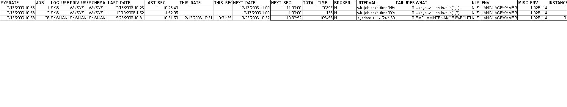

    See attached file with information about job 26 from DBA_JOBS generated using following sql
    select sysdate, dba_jobs.* from dba_jobs
    It shows a strange values for columns: (next_date is before the current date)
    LAST_DATE Date that this job last successfully executed
    LAST_SEC The last successful execution started.
    THIS_DATE Date this job started executing (usually null if not executing)
    THIS_SEC The last successful execution started.
    NEXT_DATE Date that this job will next be executed
    NEXT_SEC The job becomes due for execution at this time.
