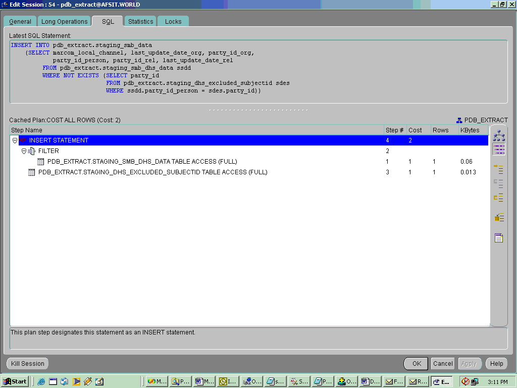

    I am a new member in the group and I am facing very strange problem. I have created one package which has 9 procs and in one of the proc there is a query like this.
    INSERT /* +apppend */ INTO pdb_extract.staging_smb_data
    (SELECT ssdd.*
    FROM pdb_extract.staging_smb_dhs_data ssdd
    WHERE NOT EXISTS
    (SELECT party_id
    FROM pdb_extract.staging_dhs_excluded_subjectid sdes
    WHERE
    ssdd.party_id_person= sdes.party_id));
    When I run this query directly on sql prompt it is executed with in 4 min.
    But when we schedule this job , the process is stopped at this query and when I try to see the long operations it shows it will take more than 2000 hours to complete. I am also attaching the execution plan of the query when it is taking 2000 hours.
    Please help me out !!!
    Regards
    Jaideep

    Hi
    Can you post the init.ora parameter job_queue_processes and also the code that is used to run the dbms_job..
    Did you include a commit after running the dbms_job ?
    regards
    Hrishy

    you are scheduling through dbms_job?
    can you
    exec dbms_job.run() ?
