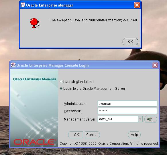

    Hi Sam,
    I've entered the HOSTname and IP Addr. of the LINUX SERVER in the hosts file of the WIN2K pc, where the OEM console is running. And I can successfully ping the LINUX server (with name & IP both) from the WIN2K pc.
    Now do I need to enter the WIN2K machine's name & IP in the hosts file of the LINUX server ?
    I'm attaching the error occuring on the console.
    (HERE THE DWH_SVR IS THE NAME OF THE LINUX SERVER. )
    Please help me .... I'm stuck ...

    Hi All,
    I've entered the hostname and IP address of the clients in the LINUX server's hosts file. Still I cannot connect to the OMS. The same error is occuring (as attached with the previous message).
    What else can be done ....
    Thanks in advance ....
